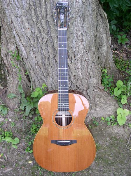

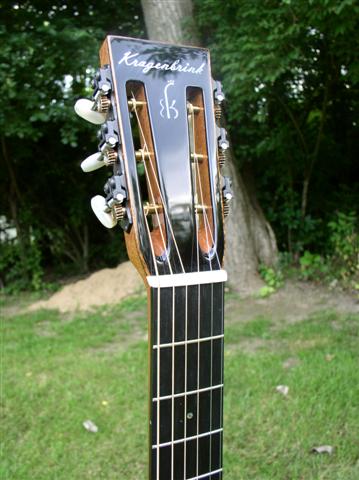

PostPosted: Tue Sep 20, 2005 11:07 pm
Speaking of 14 fret slothead
PostPosted: Tue Sep 20, 2005 11:33 pm
Lance
That guitar tree you got there is something else, it produces some very nice fruit
PostPosted: Wed Sep 21, 2005 3:09 am
Posts: 952
Whooeee
and a fine looking slot head it is too. The exception that proves the rule.
Is that your own, or a recently finished instrument?

Thanks John - That is a guitar that now lives in Santa Barbara CA. A commission.

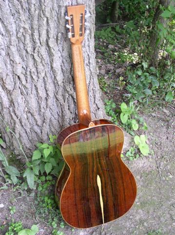

PostPosted: Wed Sep 21, 2005 3:21 am
Here is a nice one by Gary Zimnicki from Michigan
